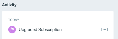

Upgrade subscription
In this example, a user has changed their subscription from the Starter plan to the Dynamite+ Pro plan. We can view that as a plain event, like this:
We could then send an auto message thanking the user for their upgrade, triggered by this event. But we can also add context by sending some metadata with the event, such as:
